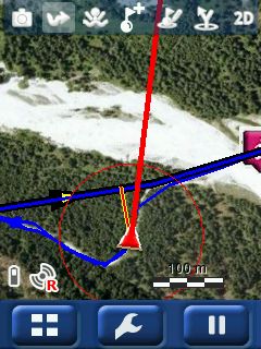

Papaluna, Loudini
I have V-map and CDEM active...
Try ALTERNATE MAP option to see:
[Blockierte Grafik: http://www.garniak.pl/download/file.php?id=7479]
