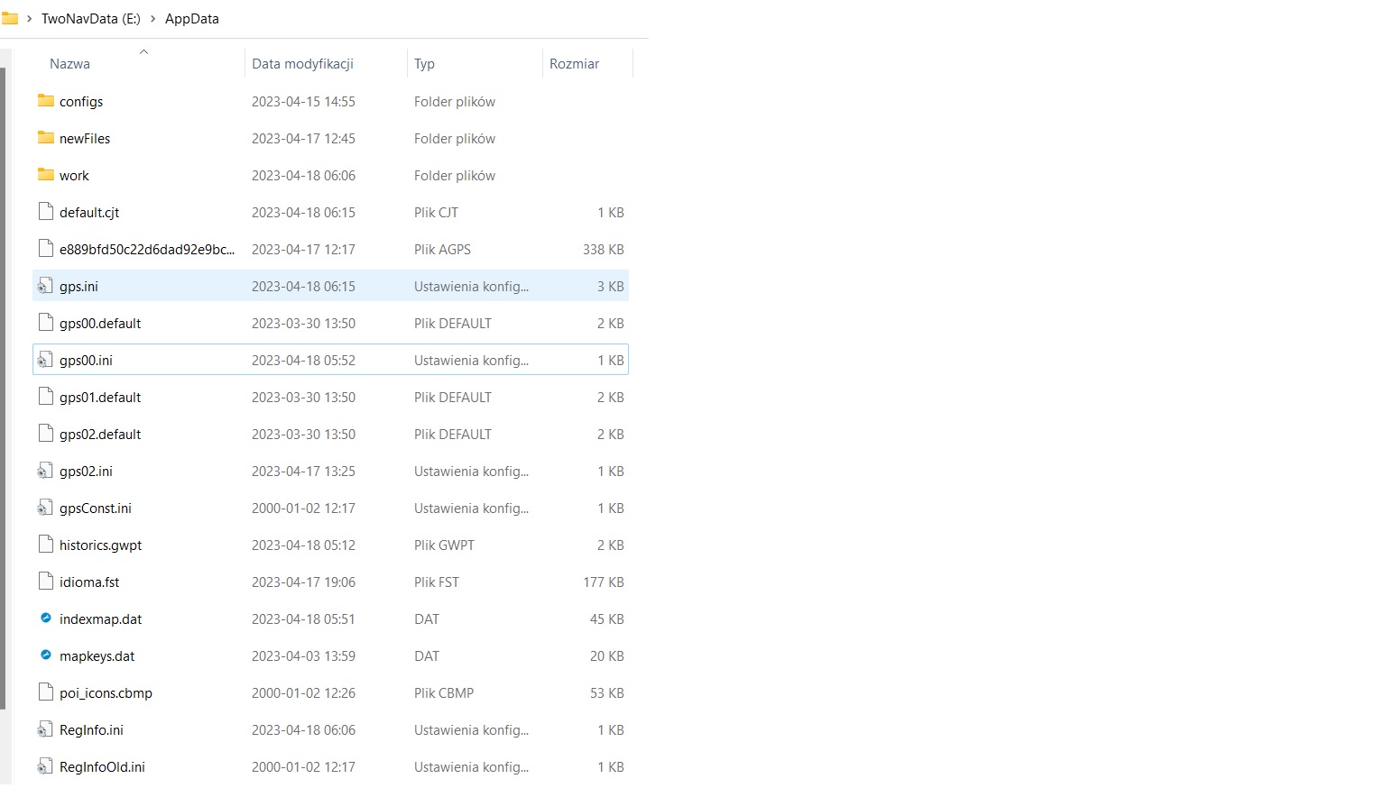

  • AddData does look normal, what's the problem?

    Regarding the AppData directory:
    1) Make a backup of the whole directory before changing anything in it.
    2) To reset the device or a specific activity, delete/rename the apropriate gps*.ini. Remember that the corresponding settings are lost with this action.
    Profiles are defined in the order they appear if select profile is pressed, for me it is:
    gps00.ini = Walking
    gps01.ini = Mountain biking
    gps02.ini = Speedbiking
    If I delete/rename gps00.ini, my walking profile is reset and a new gps00.ini is created when this profil is used.
    gps.ini is the ini file for all the settings which are independend from the activities.
