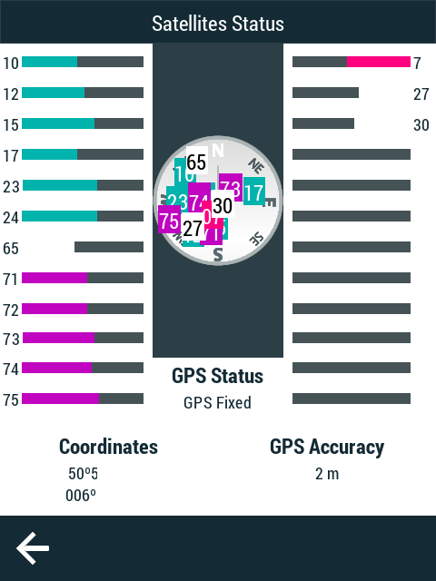

  • Here is mine - GPS + GLONASS in both cases.
    What's weird that Garmin Etrex 30 gets and holds fix immediately, whereas Cross Plus endlessely acquire sattelite system (the same sattelites are recognized: No. 10, 21, 32, and 88, but only eTrex 30x gets a fix). Opening the window solves the situation (both units shows almost the same accuracy).
    Maybe there is not that much a problem with GPS reception, but rather with the GPS fix (both: cold fix and hot fix).
    I have tried several things: erasing gps.ini, downloading fresh A-GPS, switching off all the radios: BT and Wi-fi.
    TwoNav fimware version is already fresh installed: 5.5.3.
