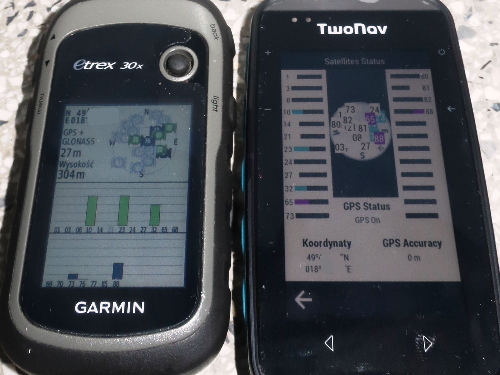

Here is mine - GPS + GLONASS in both cases.
What's weird that Garmin Etrex 30 gets and holds fix immediately, whereas Cross Plus endlessely acquire sattelite system (the same sattelites are recognized: No. 10, 21, 32, and 88, but only eTrex 30x gets a fix). Opening the window solves the situation (both units shows almost the same accuracy).
Maybe there is not that much a problem with GPS reception, but rather with the GPS fix (both: cold fix and hot fix).
I have tried several things: erasing gps.ini, downloading fresh A-GPS, switching off all the radios: BT and Wi-fi.
TwoNav fimware version is already fresh installed: 5.5.3.
What firmware version have you got?
I have 5.5.2.

I have done several tests and with comparison to Garmin Etrex 30x.
It is evident that my TwoNav Cross Plus is extremely sensitive to any physical barriers (even glass window) and immediately looses GPS signal once the window is closed.
